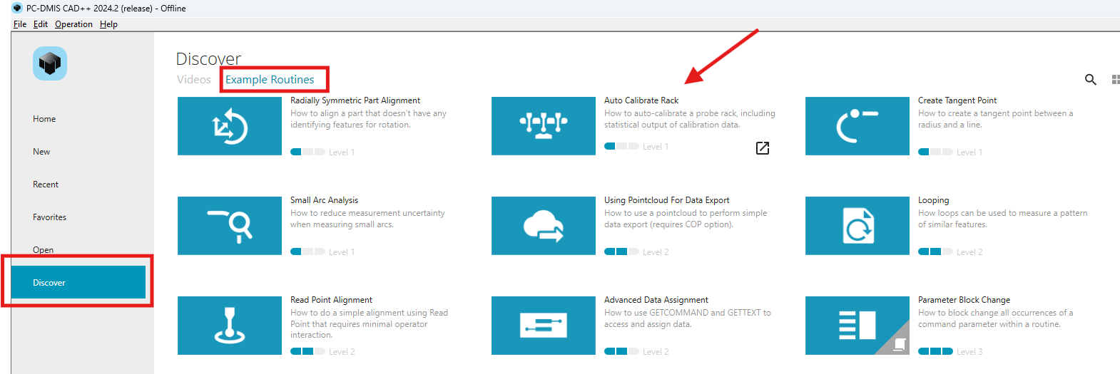

That's exactly the use case that check calibration limits functionality is designed for.  You can add the applicable commands to do exactly what you describe.
Alternatively, you could use the approach show in the "Auto Calibrate Rack" example from the "Example Routines" section of the "Discover" tab of the "Home page"...

The example checks every probe tip angle for each slot. If you are using many probe tip angles the program code would be huge.
