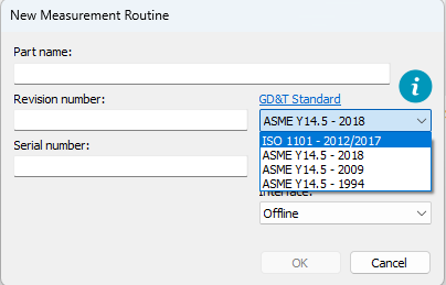

This appears to be a very old request.  In more recent versions of PC-DMIS that use Geometric Tolerance commands it is much easier.  You now select the GDT standard when creating a new routine...

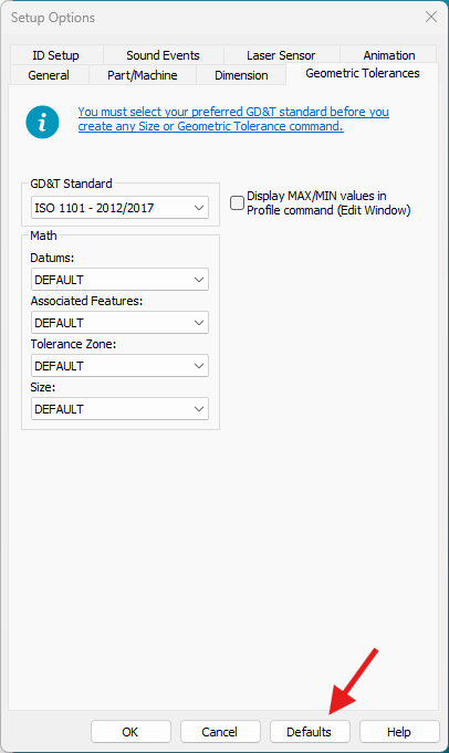

You can also set the default GDT standard from the Geometric Tolerances tab of the Setup Options dialog...
Image 733
Users of legacy dimensioning still need to open the settings editor and edit the USEISOCALCULATIONS key, but there are no plans to change that.  The USEISOCALCULATIONS setting only affects legacy profile (reports a single measured value equal to 2x the furthest deviation from nominal rather than the ASME y14.5 - 1994 two-value result).
