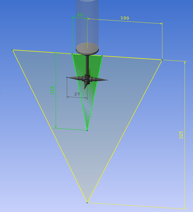

I would like PC-Dmis to warn when defining a tip that is too heavy and also if it is outside limits of what the probe can handle.
Below a tip that is outside the specific volume for an HP-S-X1S. But inside an HP-S-X1H
The weight of the tip is 15.4 grams, so it can handle the weight of both probes but not the size and position of an HP-S-X1S.
HP-S-X1S: max 20g
HP-S-X1H: max 33g
