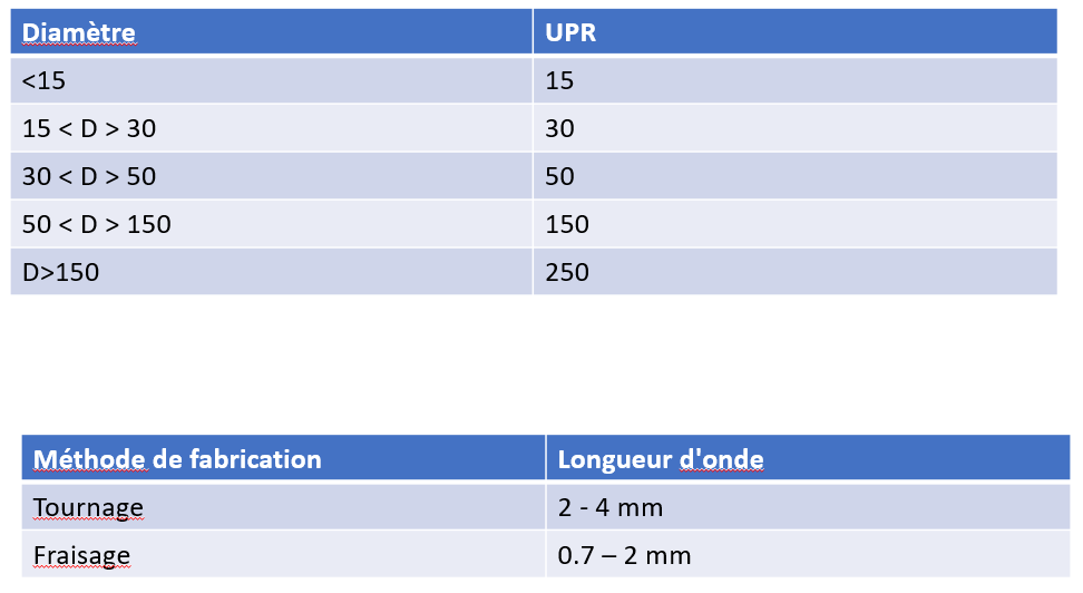

Here I hope a helpfull chart with general recommandations for a Gaussian filter:
If you choose,p.ex. 30, you need minimum of 30x7= 210 points on your scan.
Image 744
Marek,     I'm curious where you got these recommended dia to UPR filter settings?    Is this from a standard somewhere.   I see a variety of values being requested by some of my customers.    Thanks.
Those kinds of tables is exactly what I don't want. I don't want to work backwards from a UPR. I want to work forward from the auto settings from PC-DMIS.
Of course if filter settings are specified on the drawing (or in supplementary documentation), those instructions should be followed. But 99 times out of 100 this is not the case, and in those cases I'd like a nice stable and safe strategy to fall back on that works in harmony with the workflow of PC-DMIS. UPR is the last tab in the feature definition windows, so it makes no sense to first set the UPR and then go back to point density...
